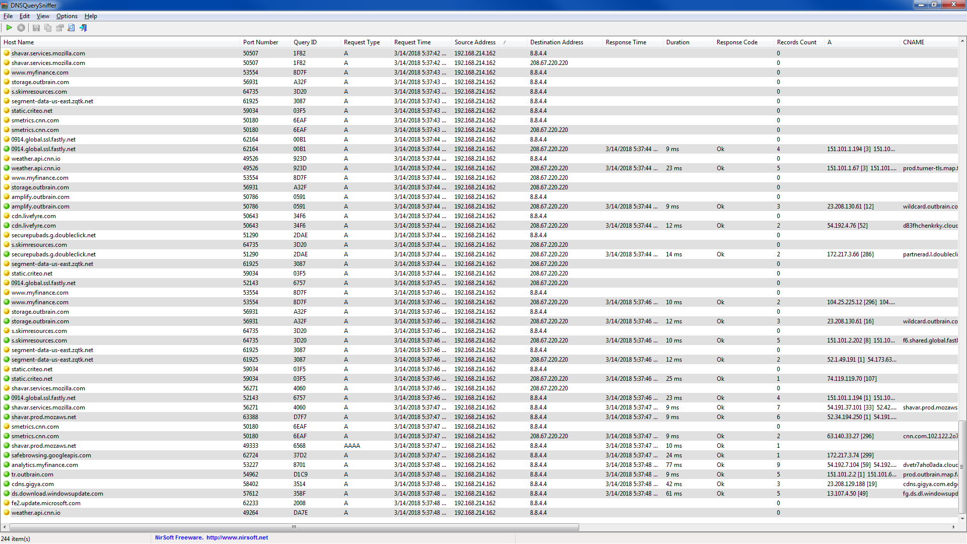

On any of the affected PCs, if I run DNS Query Sniffer the problem is made quite obvious. As the PC tries to move around the Internet, DNS Query Sniffer shows every DNS request the PC makes. A cluster of several dozen DNS queries will show as responded to and resolved. Then several screenfuls of DNS queries will show as not being responded to. You can clearly see the progression on the part of the PC of querying the DNS1 server, not getting a response, querying the DNS2 server, not getting a response, querying the DNS3 server (the proxy, if it is set up), not getting a response, and so on. After a while of this, though, seemingly by magic the DNS queries start getting responses again.
This is not a problem with a screwy PC. I can replicate this problem on any PC behind the firewall by running DNS Query Sniffer and checking its output.

Further, I can clearly see that it's the firewall causing the bottleneck if I reconfigure a PC to bypass the firewall and connect directly to the ISP's modem. With the firewall out of the way, DNS Query Sniffer shows almost every DNS query consistently resolved (with the odd miss here and there). The difference is dramatic. I can hammer the connection with DNS requests, as long as I'm hooked up directly to the ISP's gateway, and the PC won't miss a beat. But as soon as I connect the PC back behind the firewall, I can't get more than a few dozen DNS queries out before they start to get blocked (ignored, whatever).
