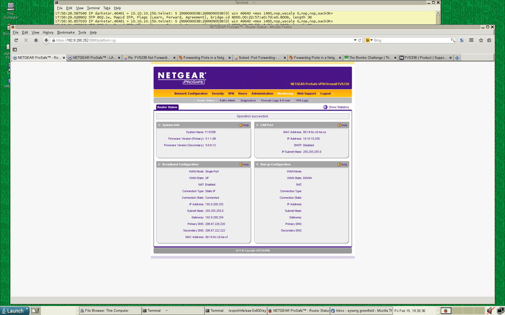

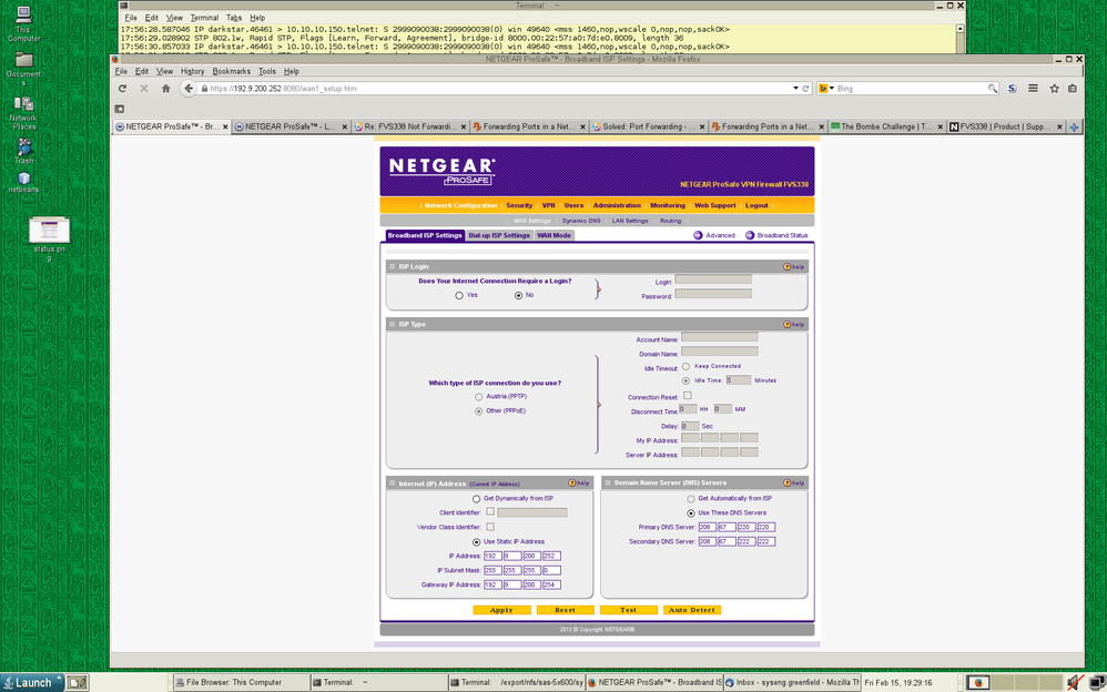

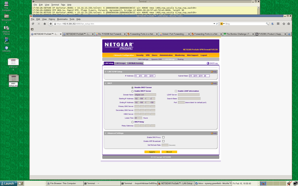

Thanks. The 338 wan side is on a secure subnet behind a hardware firewall, an experimental setup to show port forwarding works, before installing eleswhere. Overall data flow is:
Isp <-> hw firewall @192.9.200.254 <-> (338 wan side port @192.9.200.252 338 lan side port 10.10.10.250) <-> Lan host 10.10.10.150
Have remote management enabled initally, so I can login to the 338 from wan or lan side. Have tried the following:

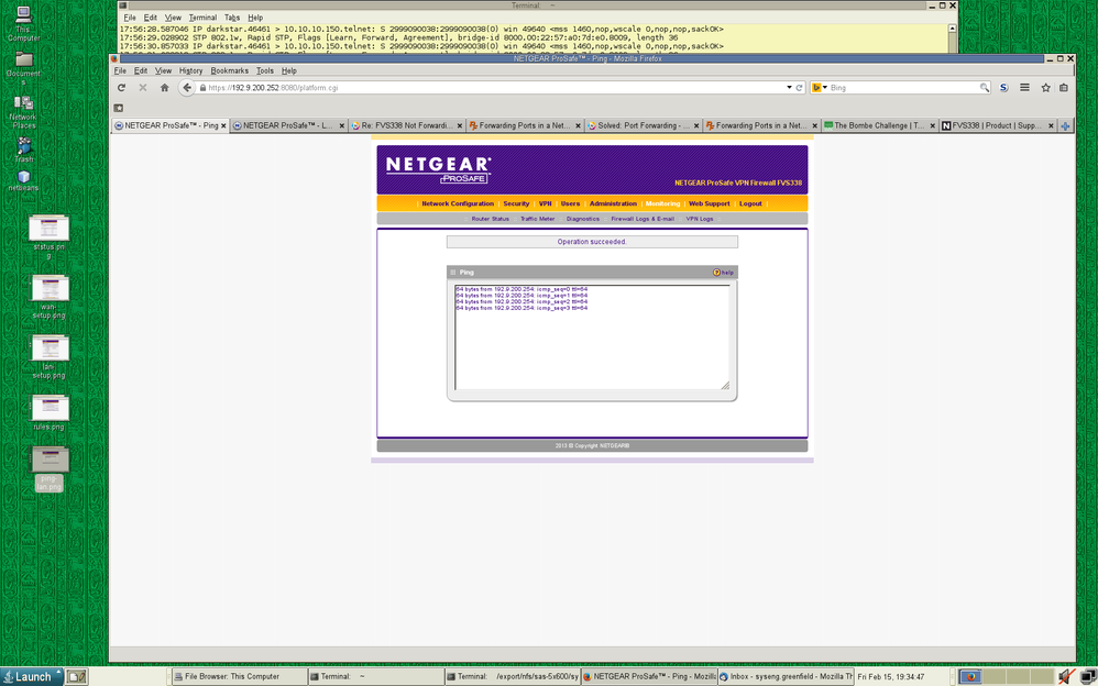

- ping to wan host 192.9.200.254 from 338 diagnostics, works, so wan host ok

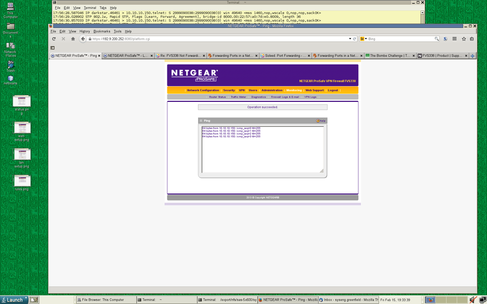

- ping to lan host 10.10.10.150 from 338 diagnostics, works, so lan host ok
- traceroute to google.com from 338 diagnostics, works, so dns handling ok
- 338 internal ntp client, sets time, works
So, it looks like the lan and wan networks and basic functions are up and ok.

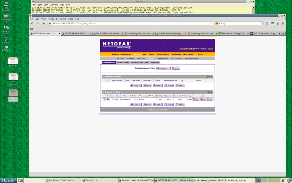

Have just one incoming rule defined, telnet from anywhere on wan -> lan host 10.10.10.15, but drops packets.
Including a few screen shots as requested in a pm earlier...
