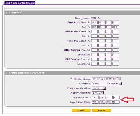

I have a real simple configuration for a Client-to-Gateway VPN setup. Basic tunnels seem to be working fine, but when I try to setup a Mode Config policy I'm getting an error upon connect and can't ...

I was able to find a solution. Turns out the firewall configuration works just fine. All I needed to do was use 192.168.1.0 in the CLIENT configuration as the Remote LAN Address, then everything worked.
Now to me this is 2 "bugs" in the SRX5308 for Mode Config Record:
1. 192.168.1.0 isn't the subnet address on the Local LAN, it's 192.168.1.1 ; The manual says if left blank it will default to the LAN subnet, which it doesn't, it defaults to 192.168.1.0
2. It will not let you enter ANY ip address here; It has to be left blank.
Maybe I'm missing something here, but it's working perfectly after just using what's there in the client end.
Should have been simple. Oh well...

I compared your screnshots to our local configuration. On http://www.vpncasestudy.com/ I read that you should use an pool IP-range that is not part of your network (in your case e.g. 192.168.2.1 to 192.168.2.100). You don't need to specify those Adresses elsewhere which gave me a hard time to accept, too. The device seems to automatically treat those IP adresses as part of your network even if not declared at network configuration page.
Based on your screenshots this are the only differences I can see. I don't know if it solves your problem, too.
