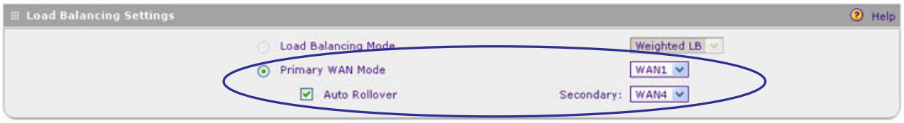

You were trying to set a static IP on WAN1 and once you hit apply, it goes back to blank fields. Is it running on the latest firmware? Have you tried connecting it to a dhcp or to the modem and check if it will be receiving an IP? Please also check if your WAN1 is set as primary and not set as roll-over.
