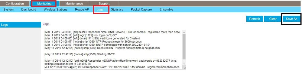

We need detailed logs from the following APs,
AP9 and AP10 from the group where you see an issue.
AP1 and AP2 from the working cluster.
AP11 and AP12 from the second cluster.
Please draw a network topology diagram as well and VLAN info.You can upload detailed into google drive and send me link via PM.

Thank you for your replies.
The logs didn't show anything useful, so I tried to reset the two AP's that were behaving weird and somehow that worked...
I have no clue why it works now, but I'm glad it did.
