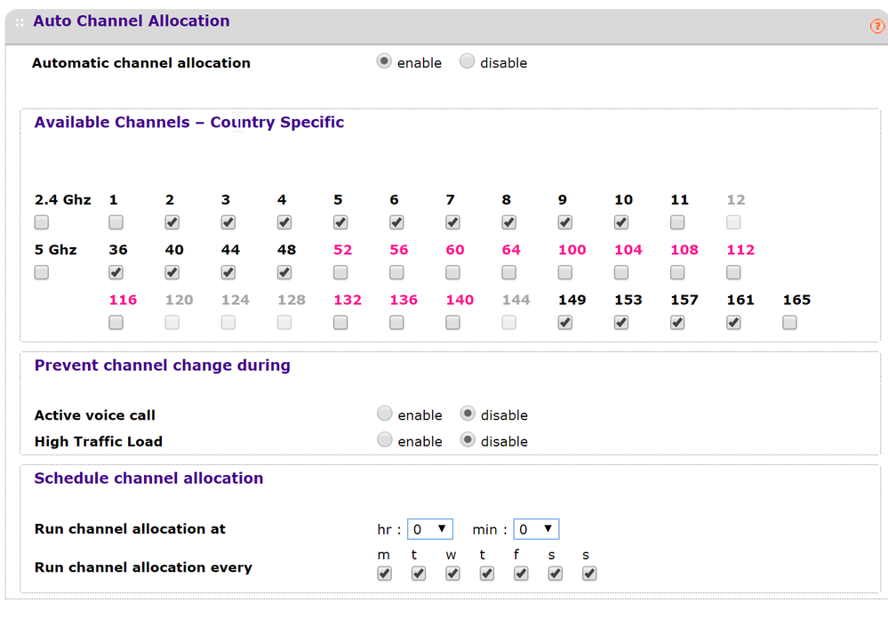

- martinavNov 11, 2018Guide
I did not find anything where I could explicitly set each AP individually, as you were implying. Or, perhaps I misunderstood. I found channell allocation, however, and was able to turn off channels 1 and 11. That at least eliminated those channels. It seems like the controller automatically selected different channels for the APs. So, I think this is doing what you requested. With that said, I'm still getting environment errors, but just on different channels. Log attached.

- martinavNov 26, 2018Guide
It does appear I had two problems... One was the channel suggestion, which I showed as the "answer" for this post. The other was that my DNS settings were somehow erased from my router. I have corrected both, and it is working reasonably well. I still have problems with ipads disconnecting and reconnecting. That isnt right, but I have run out of energy to mess with it any more.
