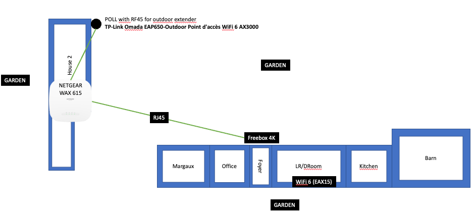

      I would like to have a wifi6 meshed network. I have a big old house with big walls and a big garden.
      This is my current setup I'm not happy about.TP-Link is not plugged yet.
      Do you have an advise on the setup I should get from here?

        Your setup isn't that bad. You have the WAX coving one home and the freebox/EAX coving the other.
        With a tplink outdoor AP.
        If they networks aren't in range of each other (or signal is pretty weak), you'll probably roam fine. Again, provided they're isn't to much overlap.
        If it was me and I had whatever budget I needed?
        I'd hold off a bit as wifi 7 devices are starting to be released. Not that you need wifi 7 but when it does, the wifi 6/6E devices go on sale more as well as you see more refurbished items. You could switch to a full either orbi consumer or pro setup, or even just switch to use the insight AP's (like the WAX) for a mesh. You just have to stick within the same ecosystem. Right now you're mixing consumer gear, pro gear, and different manufacturers. Wait and watch to see what line of gear has all the equipment you want and stick on that line of equipment.
