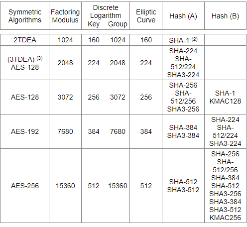

ugale11 wrote:
About the MS108EUP switch, whatever PEM i try to create i am always getting the invalid format error, no matter what i try. Even if i let the switch generate a certificate and then upload it manually back, i get an error too. I would like to use my self signed one with my CA.
Try not going beyond of SHA 256 and RSA 2048 to start with on the switches.
