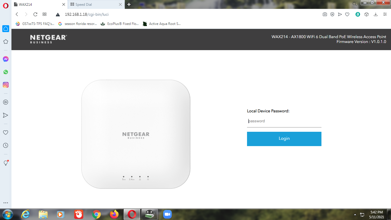

Netgear Business AP WAX214 - AX1800 WIFI 6 Default local Device password.
What is the default local device password for these APs. Ordered 4 of these units to test for deployment in a number of dead spots around our institution. I can connect to the devices via the IP ...

I have indeed taken a look at this link, as well as the configuration and installation leaflet enclosed. All attemps eventually lead back to this page.
I have tried firefox, chrome and Opera web browser on Windows PC. I use Ubuntu linux extensively and have tried Brave, Chromium and Dissenter web browsers on a different PC.....Still gets to this page. Have also tried the "Password and password"
These are new units out of the box and have not been activated or configured.
- RaghuHRMay 10, 2021NETGEAR Expert
Hi MIS200
Can you share the screen shot where it is asking for the device password? Please share your AP configurations.

- MIS200May 11, 2021Guide
These are 4 new APs that I have recently purchased and first time out of the box. So I have not configured any of the units. I am not new to APS as I have configure in excess of 50 Cisco and Ubiquiti devices at our school. These are our first netgear APs though.
