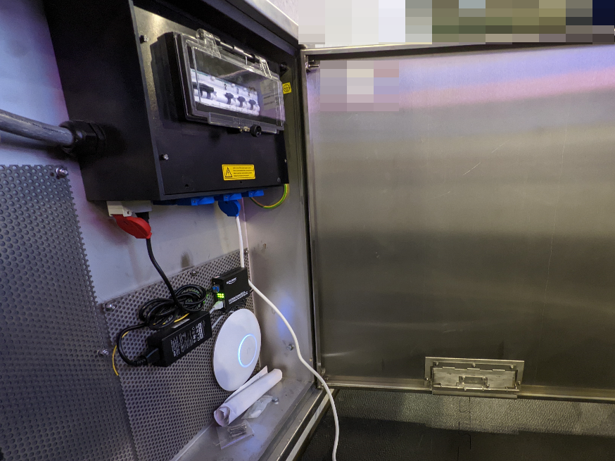

    Just design and WAF does never lead to good solutions, certainly not for Wi-Fi. A wireless AP can't provide if hidden and shielded behind shielded electronics. reminds me to this AP I've spotted these days at a customer site - fully shielded in a VA or V2A box:
    lMOA 8-((((
    PoE pass-through is available in the market for very small switches and low-power devices only, for example on the GS105PE. this isn't an advice for this model - check the https://kb.netgear.com/25541/GS105PE-PoE-troubleshooting to get an idea about the challenges. And again: No, there are no APs which can be powered from a GS105PE. No way to make the magic you expect for driving beasts like a WAC540 (three WiFi 5 radios), or a even more power hungry WAX630 or 630E (three WiFi 6 2.4/5 GHz radios resp. two WiFi 6 2.4/5 GHz radios plus 6 GHz radio. The key reason for having dual Ethernet ports is to bring more bandwidth to these APs. Magic wonders are not possible (or much to expensive should there be a niche product). Needless to say, this would require even more power than what eg. a WAC540 or a WAX630/630E would require - on top of for what would be required for powering a switch...
