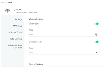

Thank you very much for your posts. I forgot that I setup an ACL over a year ago when I setup this device. When I checked and rechecked the Insight page that allows me to configure an ACL, I kept focusing on the Wireless Settings and Security Settings and skimmed right past MAC ACL because I forgot that I set it up. Dumb mistake.
As a consequence, when I tried to add a new device to the WiFi network, it was rejected even though I submitted the right password because it's MAC address wasn't in the ACL.
Your help is greatly appreciated. Thanks again.
