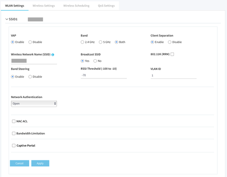

WAC510 low coverage since last firmware 1.2.5.11
Hi All, Since I updated the WAC510 with the last firmware (1.2.5.11), I noticed a big drop of the wifi coverage. Any advise before to try to return to the previous firmware to test ? Regardin...

- StephanfoMay 16, 2017Aspirant
Hi all,
Yes, reset to defaults solved the problem. Thank all for your help.
For the information, after factory reset, the RSSI Threshold is set to -85.
Stéphane.
