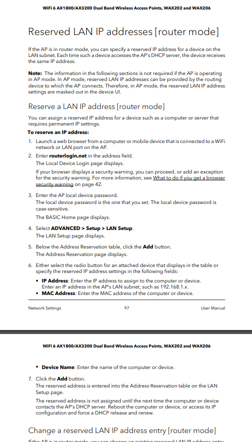

wax 206 need to set up static ip for a computer in my house
I have never seen such a complicated router before and I have pfsense all the way down to isp routers for last 30 years
ALL I need it to set a staic ip for one computer in my house, all i found was in advanced and that does not allow it, always fails
so I have a small server in house I want to set it as 192.168.1.2
can someone help me out on thi sunit? I just got it from Amazon and may have to send it back

    After a 35 second browsing the WiFi 6 AX1800/AX3200 Dual Band Wireless Access Points, WAX202 and WAX206 User Manual on p.97 ff. I  would suggest to start from ADVANCED > Setup > LAN Setup
    You might want to explain the uneducated reader what does fail, under what condition, what Web browser, what WAX206 firmware .... just some more essentials of what you report here. "It always fails" does not last long.
    Some basic ***-in and ***-out example, probably with a screenshot might explain your issue. Is this potentially related to the IP address or the format used for the MAC address?
