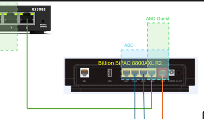

Dnomis
Mar 31, 2025Aspirant
Many thanks for your reply. I am trying to get my head around the last part but I think I got lost around where the Trunk port was introduced...
I have tried to map it out on the attached picture but I think I got lost...
What am I missing?
What am I missing?
- schumakuMar 31, 2025Guru - Experienced User
There will be two different Ethernet links required, one will be the normal LAN, the other the Guest LAN.
ABC and ABC-Guest can't be on the same LAN port, because the BiPAC does not support a VLAN trunk. A dedicated port for the ABC-Guest is required, so a additional dedicated physical Ethernet link for the ABC_+-Guest is required - this is what the router does allow.
