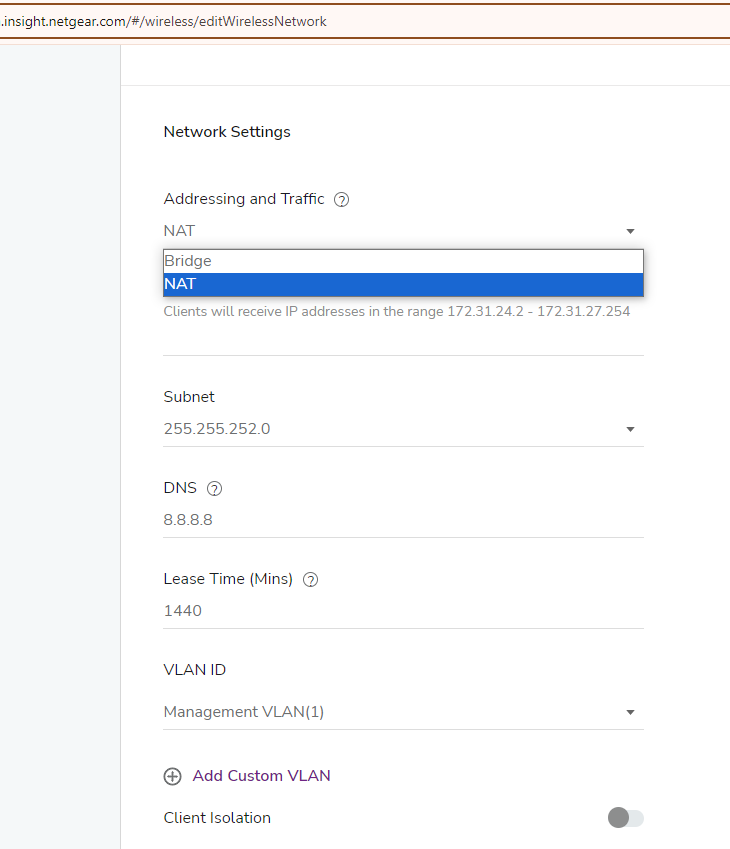

I would just like to ensure my guest SSID is secure and when guests log into it, they do not see or can connect to printers or cameras on my main network. I only enabled “client isolation” on the SSID configuration page but that seemed to not do anything. I did a test and I could still see my cameras and printers while on that guest network.One possibility would be to configure the Guest SSID to be - instead of bridged to the main network - in NAT mode: This does create a pure WAX6xx local network. Means Guests can reach the Internet, however can't discover other guests, and not even that NATed local network on your infrastructure, on your other APs, ...:

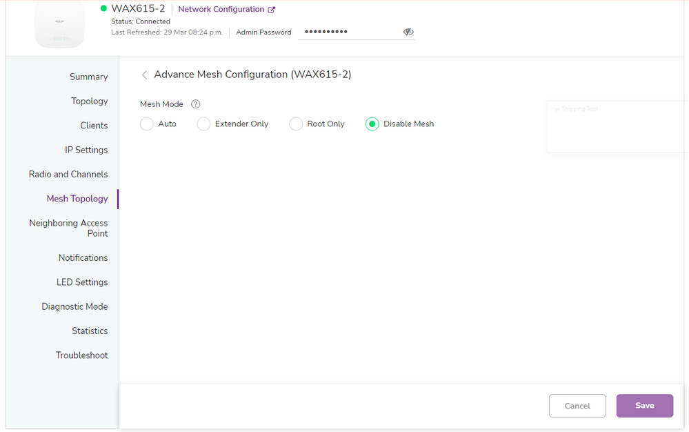

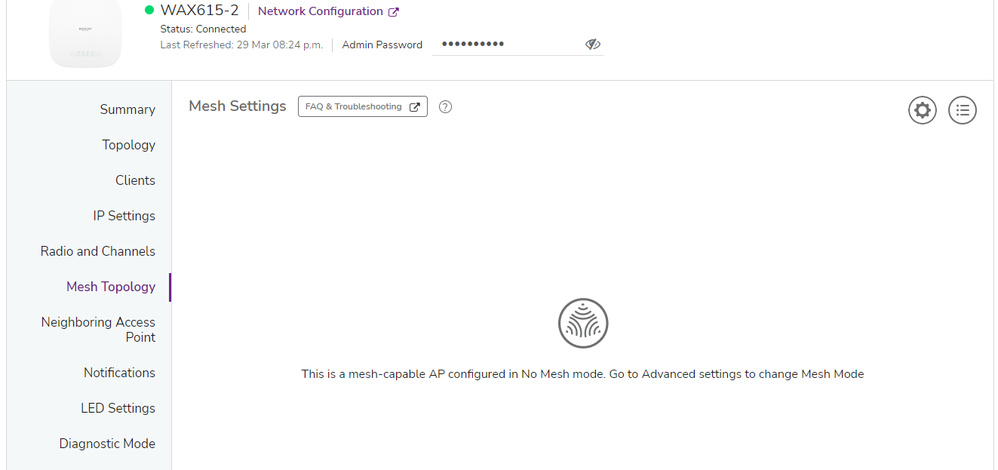

- ThedeckTutorThanks for the reply and information. I will switch to NAT for the guest network and give it a go. Should I also remove the “root AP” setting for the garageAP? I would just like to ensure seamless connectivity between the two APs I have.

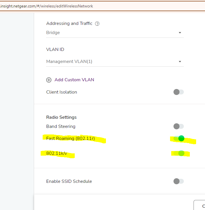

Reading to much consumer Mesh marketing literature?
With all WAX6xx (and WAC5xx) - all connected to a wired network, with each AP configured to the same SSID, the same security (PSK, WPA2, ...) - this functionality is granted. Insight cloud does care about the WPA3 part. All you have to do is enable 802.11k, 802.11k (everything done automatically when managing multiple APs in Insight for the same location), plus 802.11r on each SSID.
Enabling any kind of Mesh is required only in case you have some APs (WAX6xx) operated in Mesh, using a wireless backhaul - then one, ideally two or more can act as wired root(s). And one, two or more can be operated without a wired backhaul.
