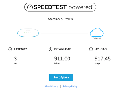

Below is a screenshot of two devices connected to the AP and it advertises 800Mbps down and 7-800Mbps up. One device is 2x2 AC and other other is 2x2 AX also not pictured but the android device is a 4x4 AX i beleive.... its a S22 Samsung.. Might be 2x2

The newer S22 can do HX80, certainly the higher end plus and ultra (names from wally brain) are certainly AX systems3, capable for HT160. lLink rates look correct in the 800 mb/s range for both the AC notebook as well as the AX mobile. Keep in mind this is WiFi, not Ethernet, so the throughput can never reach the link rate. however, some 450...550 mb/s should be feasible.
*Very unlikely mobiles are anything different than 2x2 - by far to much power required (and by far to expensive).
