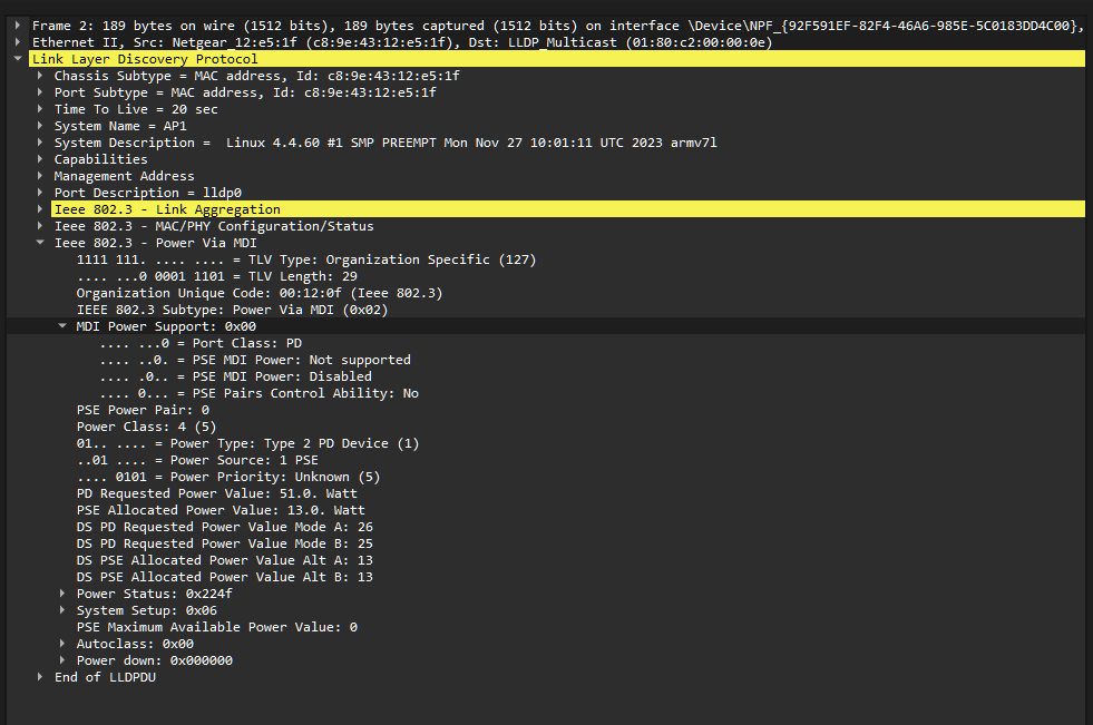

WAX630E not negotiating 802.3at POE+ via LLDP
Hello, I have a site that is transitioning to WiFi6 and the APs will need to be put on the existing Cisco WS-C2960X-48FPD-L switches as we are transitioning the access switches with a different p...

Hello Schumaku,
A support ticket seems like the way to go.
We’ve actually had these APs for about 6 months now powered by a Cisco C9300 switch via 802.3bt. They’ve been working fine there. While doing basic troubleshooting, I read some release notes about the WAX630E not negotiating PoE++ about a year ago and I upgraded the fw to see if it would fix the issue I’m having as well.

Dear Support Team,
I'm facing the exact same issue with the same product and a Cisco switch CBS350-48NGP-4X which can deliver 60w. The PoE port works perfectly with other AP and IP cameras.
Thank you in advance for your support
Max
- GDrosarioJan 21, 2024AspirantAs soon as I get it back it on the test bench I’ll fire up Wireshark and pull the logs.
