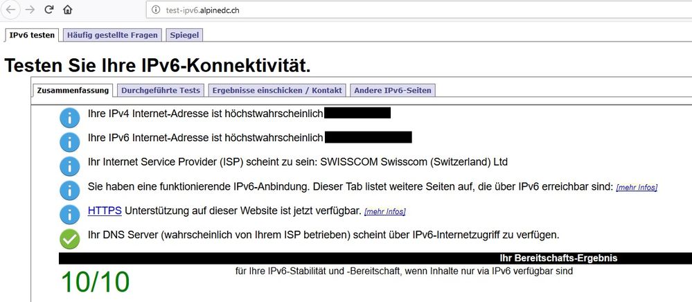

Useless. We need full support for the 256 VLANs - and each must be able to run it's own IPv4 subnet with DHCP, NAT options, and so on. Beyond we need capable and smart IPv6 options - including bridign, IPv6NAT/translation to map a dynamic provider supplied IPv6 (like the client-only IPv6 supplied by Swisscom) to static internal configuration. Needless to say, we need a unique fixed DUID, DHCPv6 support, ...
