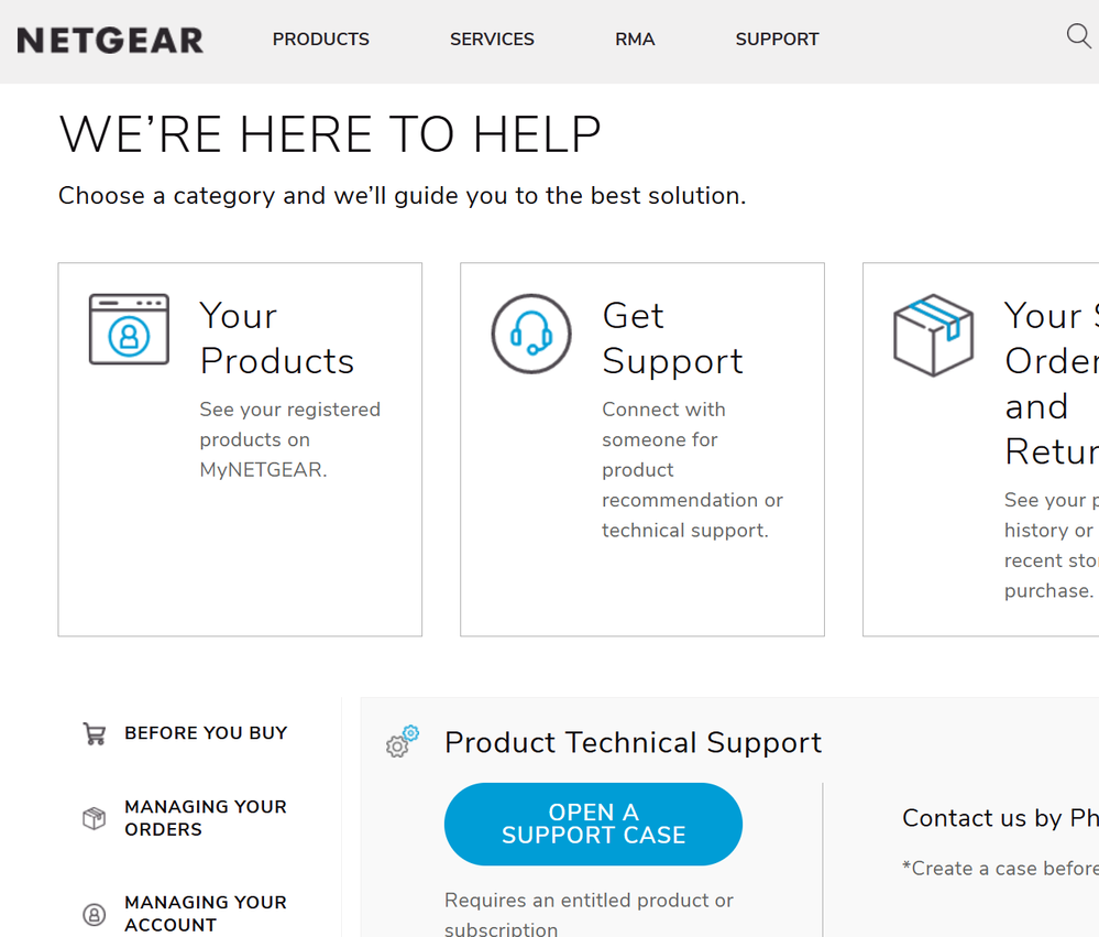

Active Insight Subscriptions always include support.
Head to https://my.netgear.com/support/contact.aspx (login inc case you are not...)
Get Support -> Open a Support Case

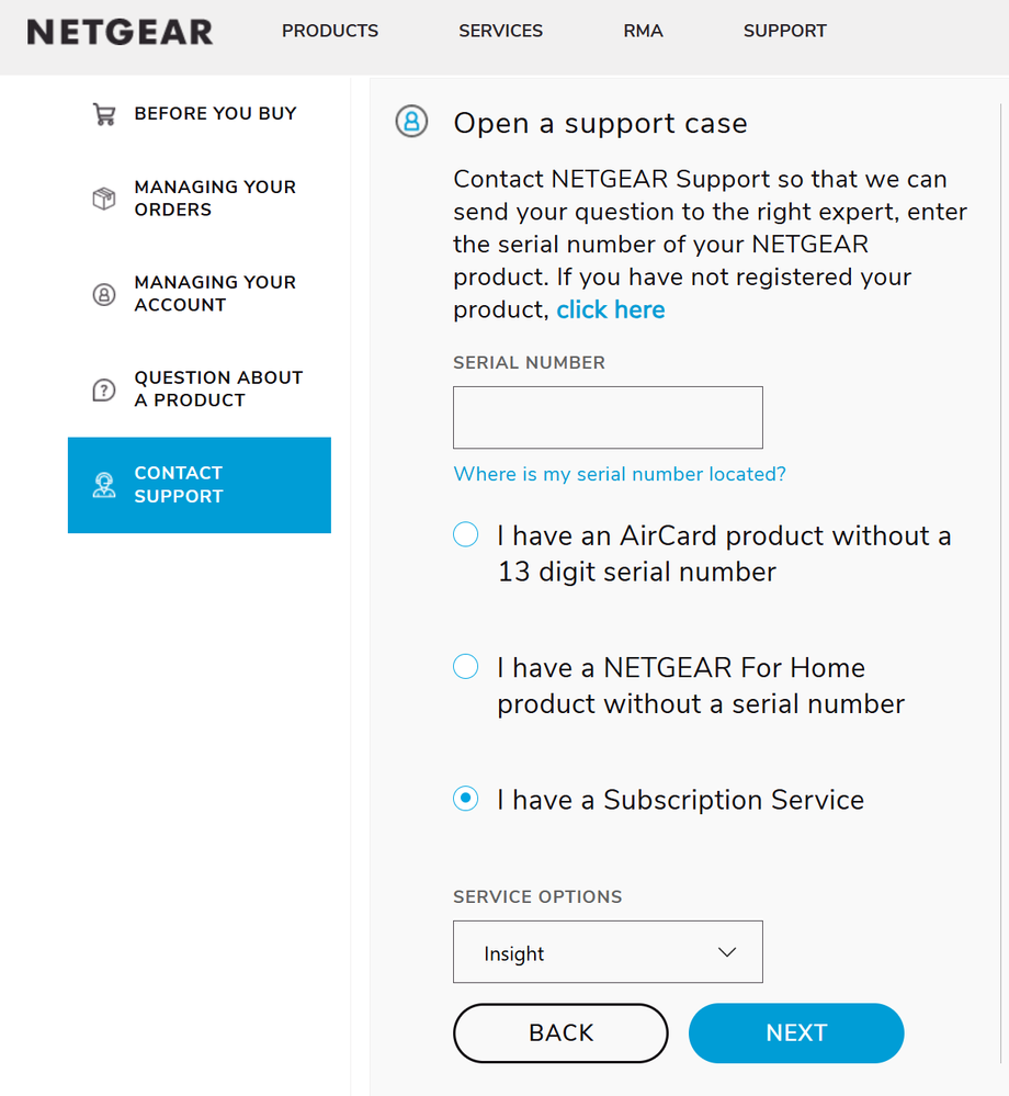

Select (x) I have a Subscription Service
Select the Service Opitons: InsightBest way is then to Call Support (Chat is often overloaded).
Provide a -brief- description...(no idea why the online imsgaes are once more not showing up here again...)
