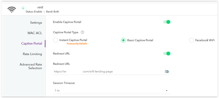

I have a Guest SSID that works as an open network. When I turn on captive portal, that works too. When I turn on and add a Redirect URL, the redirect does not work at all. Any issue with this field? ...

- tosh30Aug 15, 2021Aspirant
Dane,
Thanks for answering the call.
1. No. It is the VERY first AP that I've setup on Insight and it didn't work from the onset.
2. Yes, but didn't make it work as designed.
3. I believe the firmware is up to date (see pic)
Thanks,
Jason
- tosh30Aug 23, 2021Aspirant
Update to this issue - after testing on multiple devices, the issue seem to be tied to Android devices only. On a Windows laptop or iPhone, after clicking Accept, the browser is redirected to the landing page. On the Android devices (specifically speaking, OnePlus OxygenOS), the WiFi connection manager opens up a proxy or embedded browser, which opens up the Netgear Accept page. The browser doesn't recognize the redirect to my setup webpage. Unsure how this is going to be resolved. Will test on more devices.
