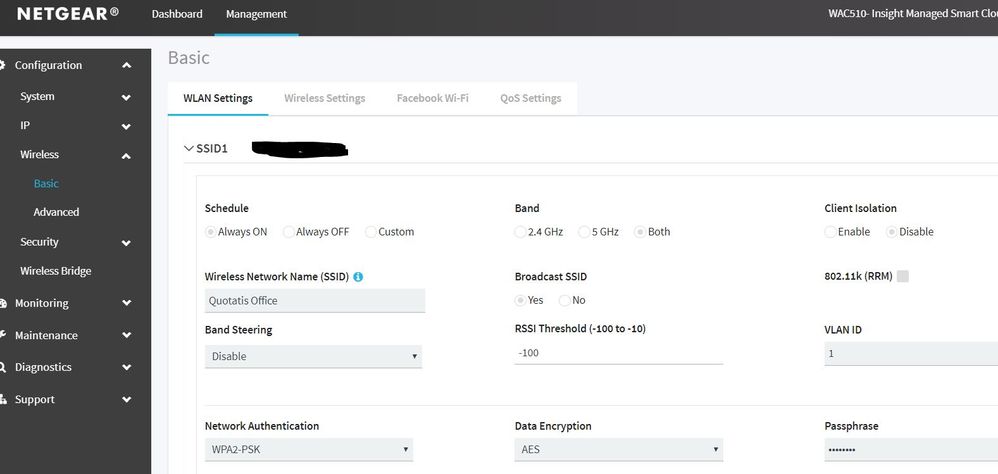

WiFi On/Off Schedule missing from Insight controlled Access points

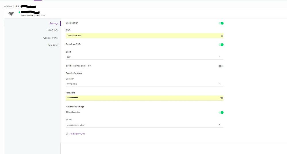

We have three WAC510 Access points controlled by Insight but need the Schedule the WiFi On and Off but have not option for this from the Insight website.On the Access points direct access this is grayed out as per the photo below. I have also attached the Insight view.

Hello,
That is correct, currently WIFI scheduling can be done on the AP itself and not through Insight. This is a good idea and I recommend posting it under the ideas exhange section to have this feature considered by engineering.
With the WAC under Insight management control, the scheduling is not accessible on the WAC505/510 - as the OP mentioned, it's greyed out - at least on the current v5.0.10.2 firmware. Well, I don't see any real business requirement for this feature anyway, but that's another story.
