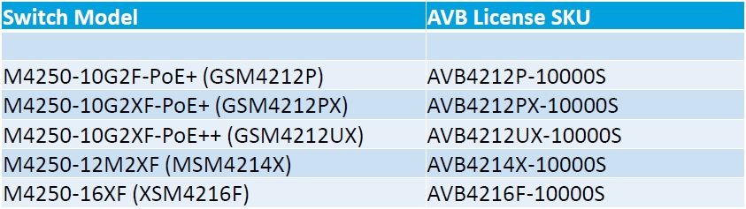

      Yes, you are correct.  As a reminder, the AVB licenses are model specific so make sure that you purchase the AVB license that corresponds to the specific switch model.
      As reference, kindly check the table below:
      Regards,
      DaneA
      NETGEAR Community Team
