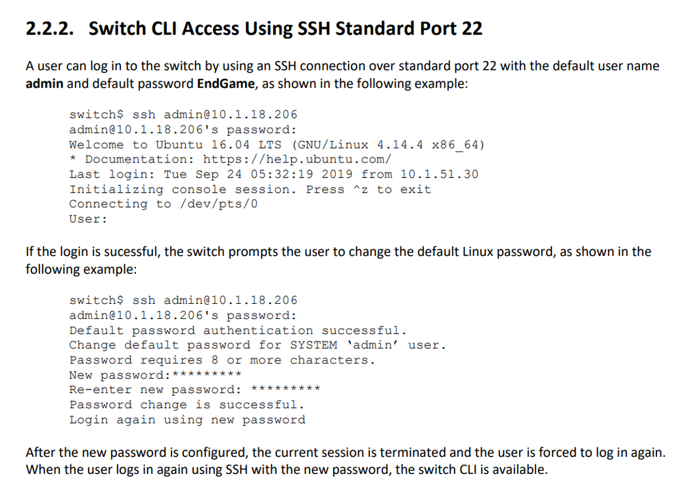

    login as: admin
    admin@xxx.xxx.xxx.xxx's password:
    Welcome to Ubuntu 16.04 LTS (GNU/Linux 4.14.4 x86_64)
     * Documentation:  https://help.ubuntu.com/
    Last login: Mon Jul  3 07:53:36 2023 from 172.22.0.101
    Initializing console session. Press ^z to exit
    Connecting to /dev/pts/0
    User:admin
    Password:************
    (M4500-48XF8C) #
    It accepts on port #22, and once you have logged in, you can then login into the CLI of the switch.
    Mike
    • SecretSquirl's avatar
      SecretSquirl
      Sir,
           Thank you for the response...and your instructions make sense, they just don't work. We changed the ip ssh port to port 23 (one of the allowed ports through our main firewall) to establish the initial remote connection. When trying to configure the ssh port to port 22 I receive the message "Couldn't set the SSH server port number (already in use) even though in the running config it states "ip ssh port 23". This is also while I am connected to the CLI through port 23...so how could port 22 be in use? I hope this makes sense. Also on an out-of -the-box switch I followed your instructions to connect via port 22 with the default login and get Access Denied.
