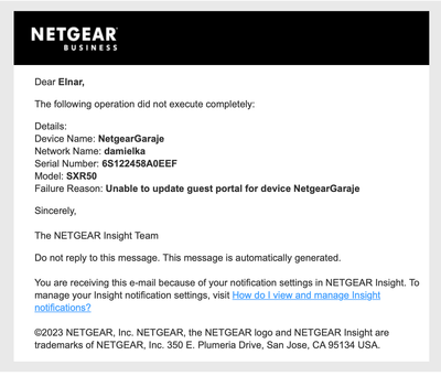

Whenever I try to set any parameters, e.g. enable Guest wifi via insight.netgiear.com, I get the following error by email:
And no changes take place. Tried both the App and the website.
When making changes via orbilogin.net I am able to enable guest WiFi network, but I am afraid that after a while, when insight.netgear.com will synchronise with my router that change will be overwritten and Guest network will be disabled again.
Any ideas what is causing this and what options do I have to resolve it?

 Whenever I try to set any parameters, e.g. enable Guest wifi via insight.netgiear.com, I get the following error by email. We need Netgear assistance on this issue, nothing the community can do for you here. No idea how the Orbi Pro 6 devices are logging and what information is made visible there. BruceGuo hnagaraju

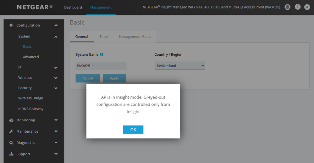

 Whenever I try to set any parameters, e.g. enable Guest wifi via insight.netgiear.com, I get the following error by email: These kind of concurrent config changes should (must) be prohibited: In Insight mode, in most areas, only Insight management must be possible. Any attempt to even access such functions should be suppressed. Reads like a bug to me. More attention by Netgear is urgently required please. Compare to the Insight Managed Access Point here for example: While I have a good selection of Insight Managed WAC, WAX, and switches at hand, I'm still digging in the dark when it comes to Orbi Pro 6 systems....
- schumakuGuru - Experienced User- hajar1GuideThank you everyone. Really appreciate you looking into it. My biggest problem that my router is insight controlled, but I cannot make any configuration changes, always resulting in the type of error I pasted a screenshot of earlier. So its like my configuration is set in stone with settings when it last worked and since then no more changes are possible. Really dreadful setup…
