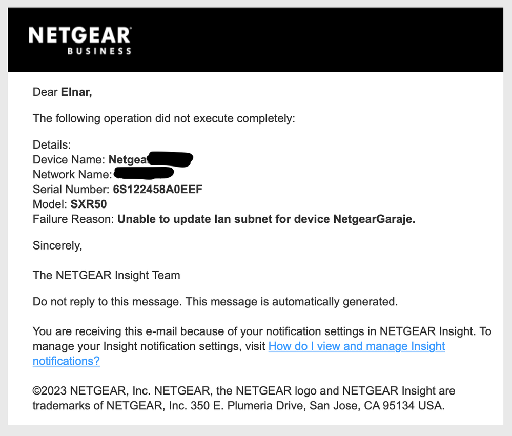

Unfortunately, it only solved half of the problem. My bigger problem is that I am unable to set reserved IPs anymore. It did work for a while so I have 7 reserved IPs, but any new IP address I try to reserve from the list of currently assigned by DHCP server I get an error. Just to be clear, I tried both doing it via local orbilogin.net and via insight.netgear.com. It is the same result.
Any idea why I have this problem and how to solve it? I really need to use reserved IPs for some of my connected equipment.
