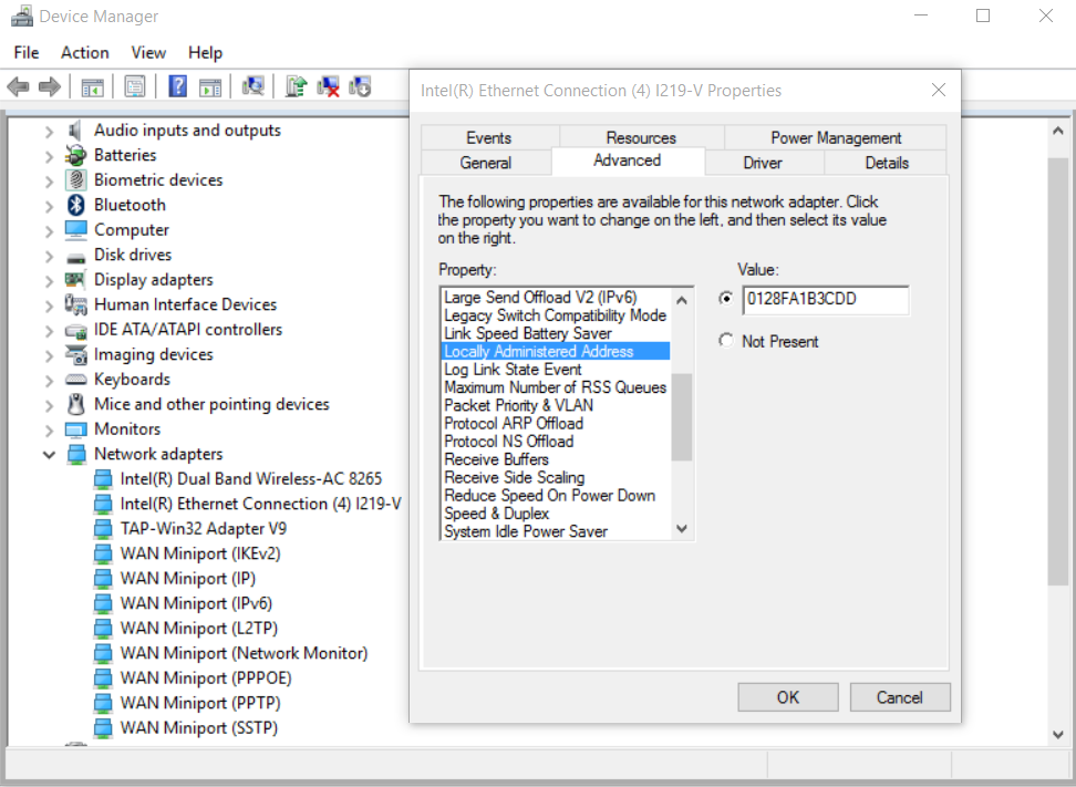

      Does your wire device install Windows or another OS?
      You may change MAC address and check if it get new IP address.
      If your wire device is Windows OS, you may change MAC address in advanced setting of Netword adapter, please see below picture.
      add a value in Locally Aminstristered Address.

        The devices are mobile phones, Chromecast, IP cam, printers and stuff like that, which cannot change MAC, and cannot even make a forced release/renew.
