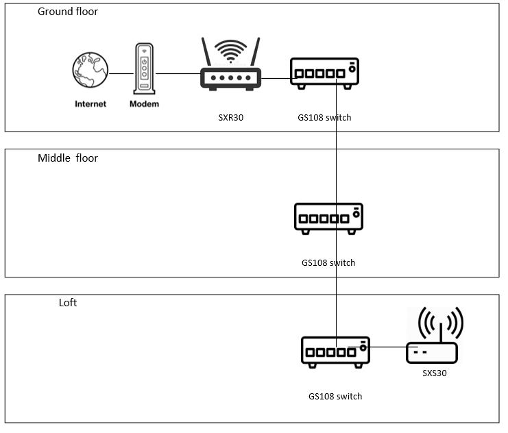

- ColdFire3000Jun 07, 2022Aspirant
Diagram of how I would like it setup
- RaghuHRJun 07, 2022NETGEAR Expert
Hi ColdFire3000 Thanks for the network diagram. This makes more clear. We are tracking your issue internally. Will reach out to you if we need more info. Have a good day!

- FURRYe38Jun 07, 2022Guru - Experienced User
What FW version do you have loaded?
That's how I have mine setup. Though I have GS105s at the Middle and Loft areas for my house.
Working well when I had it online. CAT6A in wall. CAT6 patch cables.
