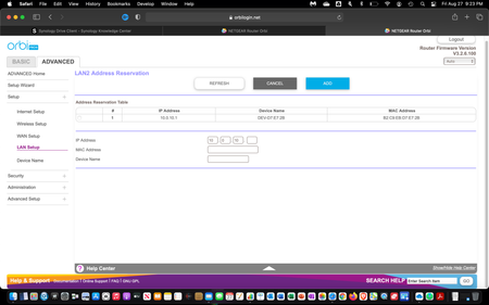

Orbi Pro WiFi 6 (SXK80) AX6000: Unknown Devices that begin with DEV.
All known devices are defined already. I believe the devices that are unknown are related somehow to the router, i.e. not a device that I have not defined. At orbinlogin.net, go to Advanced > Se...

Yes, under LAN setup, each LAN is 10.0.0.1, 10.0.10.1, 10.0.20.1, 10.0.30.1. DHCP Server range = 2 - 254. I just thought it was odd. Perhaps it is required for the router LANs to function. I was just wondering about it and Netgear support couldn't explain it.
Of course each network resp. each VLAN the router requires an address in the local IPv4 subnet ... so no "perhaps"
JasperC wrote:
So I didn't know if it was related to telemetry. I have been advised to watch out for telemetry being default enabled on Netgear routers.
Of course it's mandatory for the LAN operations 8-)
And of course it should not be listed as connected devices in neither the local Web UI (-> BruceGuo pls.) nor in the cloud with the Insight App or Web portal.
JasperC
Aug 30, 2021Tutor
Got it. So required for operations, but shouldn't be visible when adding DHCP reservations. It is only listed via orbilogin.net. Not listed via the Insight app or Insight web portal.
Separately, I noticed another issue with the Insight app and Insight web portal. When I navigate to a specific VLAN and select to add a DHCP reservation, I would expect Insight to provide a list of connected clients to choose from specific to that VLAN. However, instead Insight provides the entire list of connected clients for all VLANs. Orbilogin.net shows connected clients only relevant to the selected VLAN. So in this case, orbilogin.net gets right and Insight doesn't.
