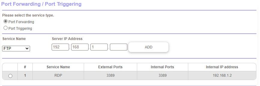

- Setup a port forward:

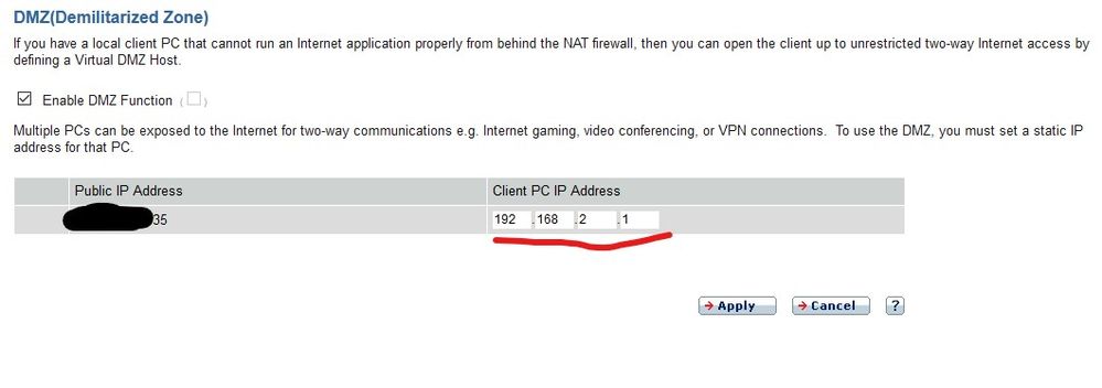

  • tl;dr; Found it. Fixed it. Updated the DMZ configuration in the bridged-modem.
    The Modem I got from the ISP (as mentioned in the first post) is very, very, very old. Any resources about putting this in Bridged mode are from 2009-2015 and are note all inclusive.
    I tried reading it all again, from scratch. Also read this post by a guy named Frank. Then I noticed the ip address in the DMZ configuration was not the same as my new Orbi Router. Changed that and it worked immediately.
    Print-screen from the configuration value I've updated:
