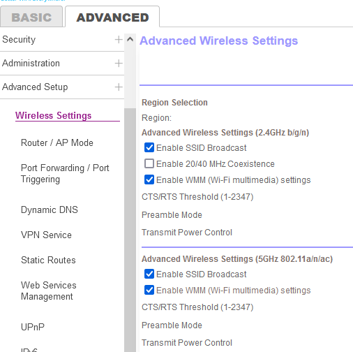

Does your system have a setting for WiFi MultiMedia?
PDA1
Aug 21, 2022Aspirant
Yes.
WMM is enabled for both 2.4GHz and 5GHz networks.

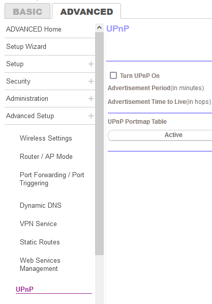

What about UpNP?
I have a dim memory of one reason Orbi's have "issues" with some unmanaged network switches is the vendor's implementation of IGMP Snooping. https://en.wikipedia.org/wiki/IGMP_snooping Notice the discussion under IGMP Querier. I found an Android app called UPnP Scanner that identifies the UpNP devices on the network and was able to find that an RBR50 router behaved differently when UpNP was enabled vs. disabled.

- PDA1Aug 22, 2022Aspirant
No worries, I appreciate you trying and help me.
My UPnP settings was on with Advertisement Period(in minutes) = 30 and Advertisement Time to Live(in hops) = 4.
