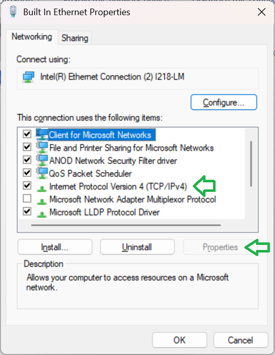

  • Ethernet connected PC or laptop

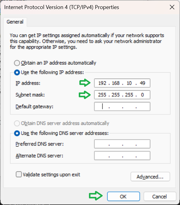

  • PC networking configuration set to the following: Manual static IP address: 192.168.10.49 and sub net mask: 255.255.255.0
Leave Gateway and DNS blank.

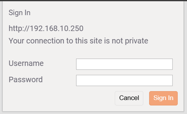

  8. Navigate to 192.168.10.250 in the web browser.
A log in pop up window will be displayed:
Enter in >admin for Username field box. Enter in >password for Password field box. (All lower case.)

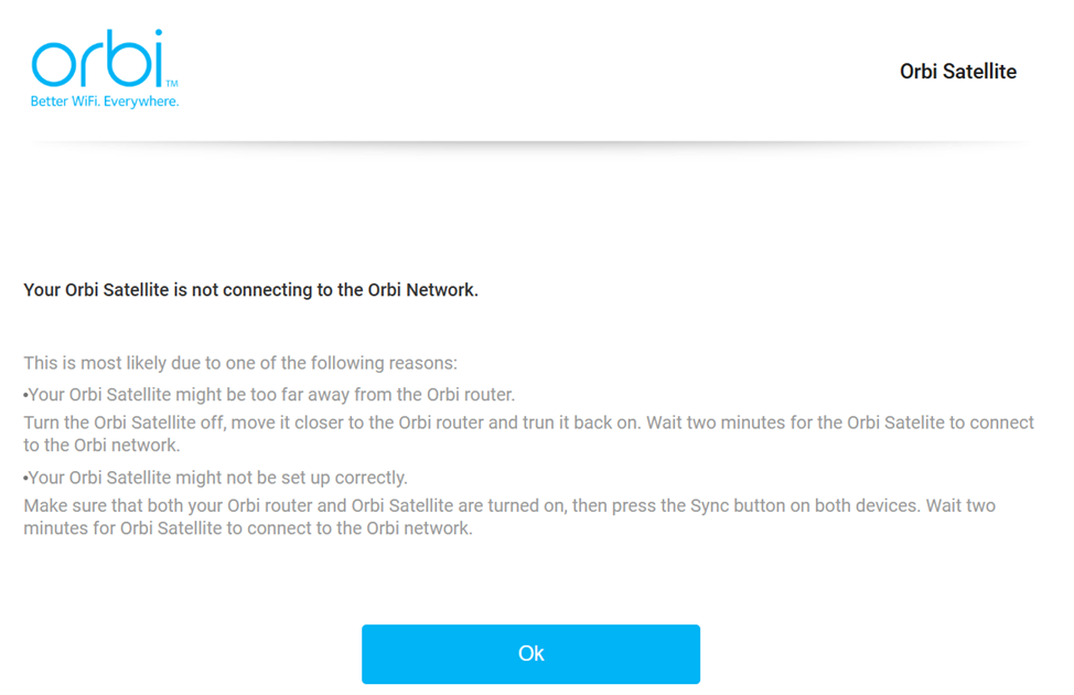

Orbi satellite is not connected message will be displayed:
Select OK.

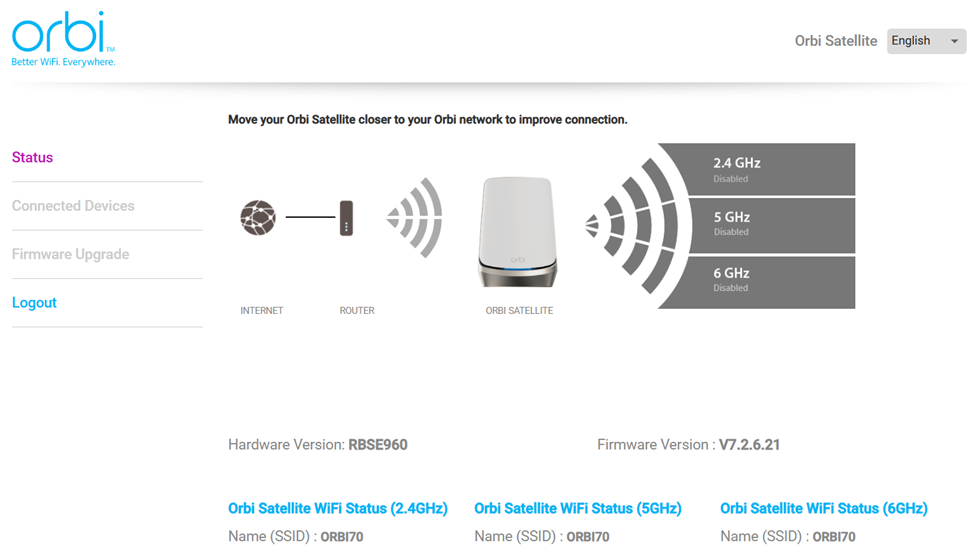

Satellite self-service web page should be displayed:
Confirm any firmware versions here. Maybe older firmware version maybe seen here.

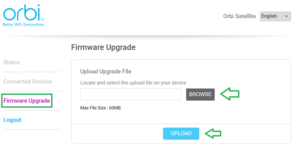

  1. Select the Firmware Upgrade menu selection on left side.
  2. Select the Browse button and navigate to the location on the PC where the firmware files are located and have been extracted too that reveals the .CHK file. Select this satellite (RBS) .CHK file.
  3. Select the Upload button to have the browser send the .CHK firmware file to the RBS.
Let the satellite process the firmware file.
The satellite should come back to ready and be able to log in to the satellite self-service web page again using same process as out lined in step 8 above. Confirm the firmware version changed and was updated.
