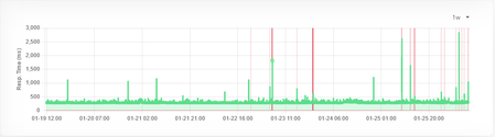

SRR60 random reboots
So this is weird! I had a previous post on this topic, but that post is now gone. It simply disappeared. I have emails relating to it, but the post is inaccessible. Hmm... Anyway, I've been havin...

Ah, well, there we go, another reboot post-factory reset... :/
