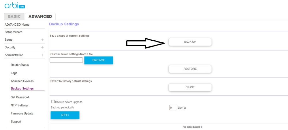

See the attached screenshot where you can take a config backup. You can upload the backup config file onto google drive and share me link via PM. We will check if any configuration is causing factory reset. BTW - Did you upgraded to 2.5.2.104?

- RaghuHRNETGEAR Expert
