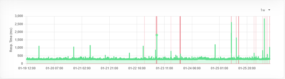

SRR60 random reboots
So this is weird! I had a previous post on this topic, but that post is now gone. It simply disappeared. I have emails relating to it, but the post is inaccessible. Hmm...
Anyway, I've been having random reboots lately (over the last 3 days, and it's been getting worse, see screenshot from my internal monitoring below - every vertical red line is a reboot). In my now-inacessible post plemans kindly suggested that one of the things I could try would be to install the recent hotfix version 2.7.1.108, which I did. Initially I thought it might have fixed the issue. It seemed to be stable and the web UI even felt a little bit snappier than before. But no, it just crashed again. :/
Does anybody here have other suggestions of what to try?
  • The only other thing I'd try would be to downgrade to a firmware version prior to the one with issues and do the factory reset and reinstall.
    If that still has issue, try swapping the SRR's power supply with one of the satellites. Maybe its having power supply issues.

      Hello again! ;] Yes, I did, just now. Waiting to see the results of that one.
      Sorry I had to start a new thread, no idea what happened to the old one.

        Ah, well, there we go, another reboot post-factory reset... :/
