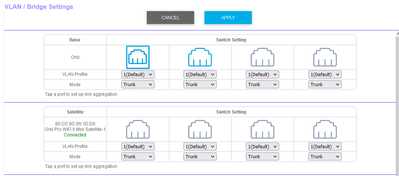

Ethernet cable from port 4 on the SXR30 router to port 1 one the SX30 satellite.
No switches in between. Nothing in between. The cable checks good.
Firmware v4.2.0.122
I don't know because the satellite is 50 feet away in my garage.
Do I have to do something to the LAN ports? Configure them so they know there is supposed to be a link there?
- Old-SteveJul 23, 2022Aspirant
So I just double checked my ethernet cable. Its good. Its not 50 feet it's 89.1 feet and all the pairs are good. cat5e.
I unplugged my ethernet cable and everything is the same so it is definitely not being used for the backhaul connection.
I plugged it back in and went to VLAN/ Bridge settings in the advanced tab.
Port 4 on the router and port 1 on the satellite both show as not being connected. to anything. But I know the cable is good. I used the same ethernat cable with my last router and wifi extender. And it keeps passing the tests.
