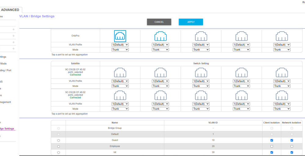

- captclam1Dec 07, 2020Aspirant
My topology is pathetically simple. I have the modem from the cable company, which is plugged into the WAN port on my main Orbi. That device plugs into a JGS516PE which has no VLANs setup at all and is the default out of the box configuration. That switch has wire devices on it. All those devices should be 192.168.1.0/24 DHCP from the Orbi.
The next hop out from that switch is another JGS516PE downstairs. I had to set one port to 100meg full duplex because otherwise my Playstation over powers the Internet. With that one exception, and the management IP set to 192.168.1.6, it has the default configuration as well.
Here is how my ORBI is setup.
Wireless 1 Nothing really to configure. Can't split the 2.4 and 5GHz so it is named Admin and unused. VLAN Default (1)
Wireless 2 SSID Separation turned on- SSIDs 2.4 SLOW 5 FAST. VLAN is Employee (20)
Wireless 3 Shut down
Wireless 4 Shut down
LAN 1 192.168.1.1/24
DHCP enabled 192.168.1.60-249
LAN 2 Disabled
LAN 3 192.168.20.1/24 DHCP 192.168.20.2-254
LAN 4 Disabled
LAN 5 Disabled
I tried to plug one of the satellites into the downstairs switch. It pulled an IP but despite being setup for SLOW, and FAST, no devices every connected to it. I set the other one about midway between the two, and it connected with good strength. I ended up pulling the plug and rebooting the one that was wired, and it ended up with a good signal after rebooting everything.
VLAN Configuration (see attached photo)-
All ports on all Orbi devices are setup for 1 (default) Trunk Nothing is wired except the cable from the Internet provider's modem, and the connection back to the the network from the main Orbi. Client Isolation and Network Isolation are disabled for VLAN 1 & 20
With this configuration, I am seeing wireless devices connected to SLOW and FAST pulling both 192.168.20.x AND 192.168.1.x addresses. Even after I have rebooted them. This makes absolutely no sense. (no they are not static IPs).
I am going to factory reset the devices and start from scratch. Here is my plan-
Wireless 1- no VLAN profile SSID set as FAST
Wireless 3- VLAN 20 SSID set as SLOW for 2.4 and Unused for 5GHz
This way, my IOT devices that can't do the auto 2.4 / 5GHz thing will have the SLOW network, and the rest can fend for themselves on the FAST network.
I think the above will eliminate the majority of my issues. However, it doesn't solve my wired backhaul issue. What exactly must I do to be able to ideally use one device connected via wire to the downstairs switch, and the other wireless? I assume the wired one will forever show up as disconnected even if I do get it to work? There is no option to decide wired or wireless and nothing in the UI for their web portals.
All in all, it has not been a good experience. I hold a current CCNA+S, so I understand networking. I worked as a WAN Engineer for 8 years. If I am having this much difficulty, I can't imagine what others are doing. I really wished there was a CLI for these devices. Then I would be able to (for example) turn off the 5GHz SSID broadcast I won't need on Wireless 3, and validate that client isolation is really turned off and not just saying it is... which is what I suspect my issue has been this whole time, and will be fixed by a factory reset

- schumakuDec 07, 2020Guru - Experienced User
It's not me, it's neither my design, nor my definition. Hey, I'm fully with you! I have done the CTRL-F while replying the first time already....
Much more I suspect that there is something borked with what Netgear does designate as "network isolation" - if disabled the routing should (in my opinion) be up. Sorry for not making this clear as part of my reply.
