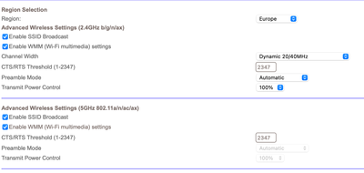

Transmit Power Control greyed out for 5Ghz radio
Hi all
I've been trying to reduce the transmit power control on the 5Ghz radio, but for some reason it appears greyed out (see below):

  • The SXR30 does make use of the 5 GHz and the 2.4 GHz radios for the (wireless) backhaul, so the power can't be reduced at free will.
2 Replies
  • schumaku's avatar
    schumaku
