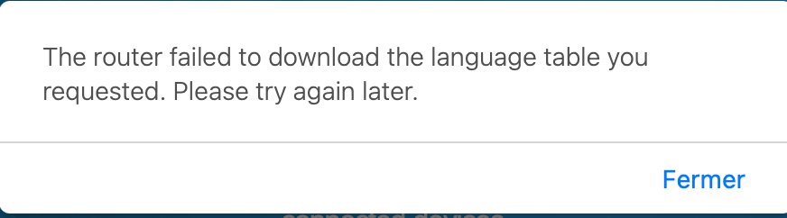

Unable to log to website orbi "The router failed to download the language table you requested"
Hello team, I try to connect to Orbi Website to manage settings through 10.0.0.1 and I get this message in a dialog box. Once the ok button is clicked website turned to 404 not Found so I can't connect. Any idea please ?
Thanks
  • Thank-you all for your contributions. Finally I succeeded with :
    1. Change default settings in Chrome for languages deleting all the languages except English (US)
    2. Empty the cache (All Time) of Chrome
    3. using 10.0.0.1 to login
    4. Access the language menu and check this was english
    Then now it works !!

      Hello; it is precisely when I try to connect to orbilogin that the issue is happening. I get the message that is attached then a quick window with a message that is too quick to read then the 404 error page.

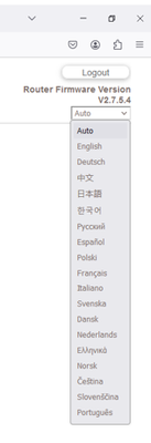

        IF it was possible to log into the router web admin, I would suggest accessing the drop down menu in the upper right to determine which language is selected:
        It is strange that the error message is in English, but the "Close" option is in French ("Fermer")
        Without being able to log in, it would seem that there is no other option: Factory Reset the router and set it up again using the web interface. (not the 'app')
        Also strange that internet search for the error message does not find even one match.  Lots of hits complaining about "language GUI" in reference to firmware updates, but nothing about logging in.
