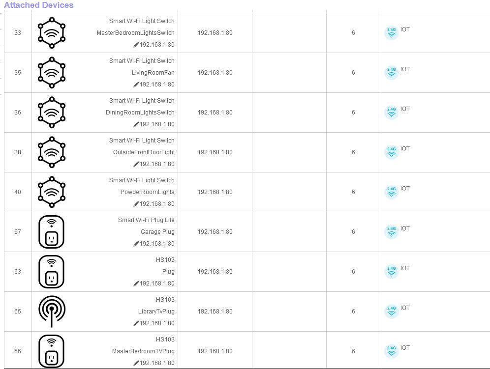

I have a SXR80 modem as well as a SXS80 satellite mesh system.  Everything was working fine until a slight power outage happened and all of my IoT devices restarted.  Of my 30 light switches, 3 connected back without a problem.  I had the same problem in the past, and it was suggested I assign static IPs to everyone on my IoT VLAN, which I did.  Looking at my connected devices, I can see a bunch of the devices connecting with correct IP addresses (192.168.30.xxx).  But I have around 35 different IoT devices that show as being connected to the modem and satellite with the IP of 192.168.1.80.  I don't have an IP range set for 192.168.1.xxx at all.  I have no other DHCP servers besides the Orbi.  Any idea how I could force those devices to connect on the correct VLAN?  I am on firmware version V4.2.3.102.
I've already rebooted the modem, satellite, and a few of the devices, but they still show as being connected with the IP of 192.168.1.80.

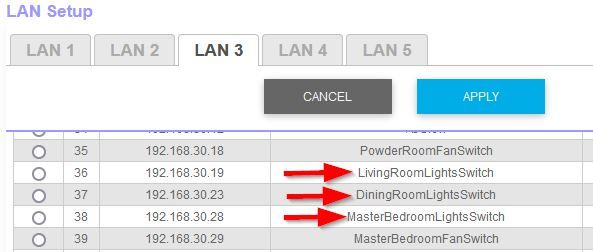

You can see the static IPs are set for these devices:

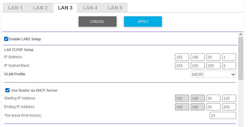

The settings for my VLAN3:

      The different LAN settings are such:
      LAN1 is 192.168.0.xxx. DHCP Range of 192.168.0.21 - 253
      LAN2 is 192.168.20.xxx. DHCP Range of 192.168.20.2 - 254
      LAN3 is 192.168.30.xxx.  DHCP Range of 192.168.30.120 - 254
      LAN4 is 192.168.40.xxx.  DHCP Range of 192.168.40.2 - 254
