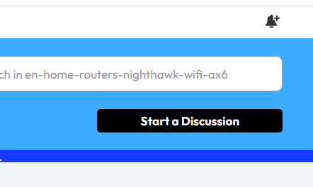

    Bosco78 wrote:
    How do you post a new question or topic?
    On the Forum page for a specific group of products, such as "Nighthawk with WiFi 6 (AX)", look in the upper right part of the screen:
