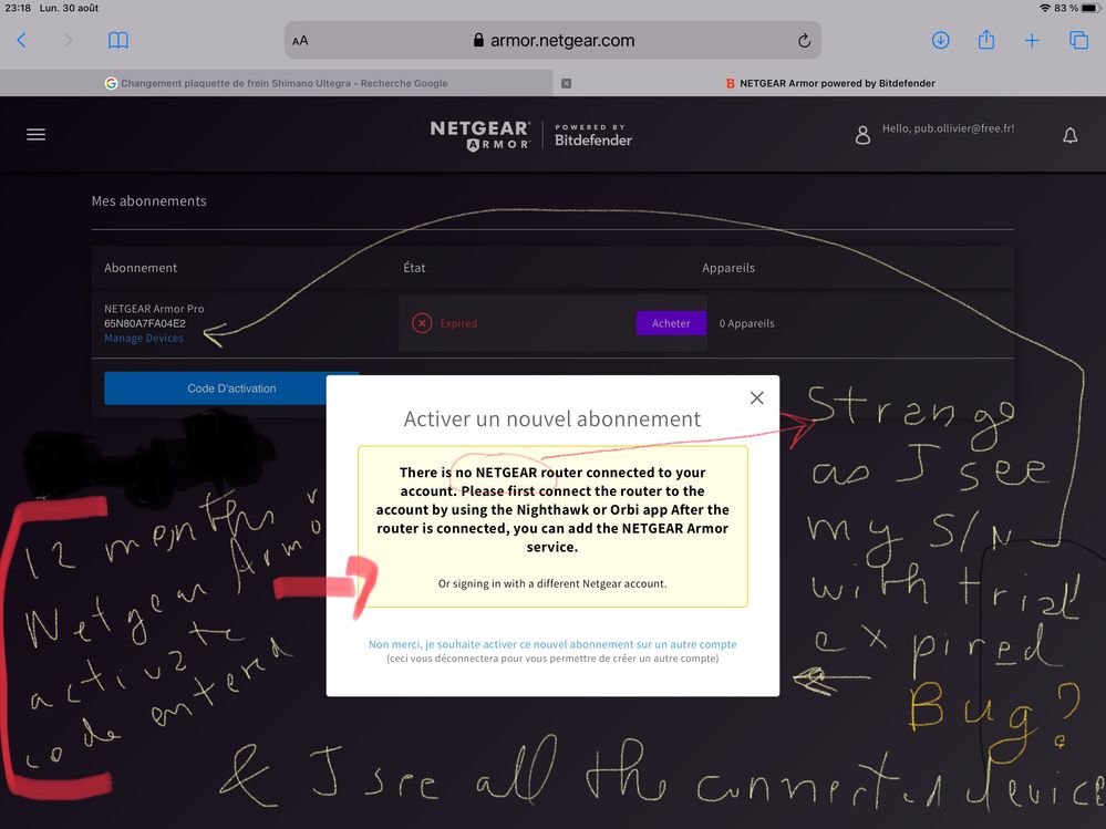

RBR850 unable to activate NETGEAR ARMOR Subscription
A while after set up, I tried netgear armor, then expired one month later normal.
Lasr Friday I bought on bitdefender store 12 months NETGEAR ARMOR received an activation key.
Login on armor.netgear.com (operated by bitdefender), the router is seen as I can display the devices seen by the wifi router and the serial number is under the trial subscription.
I enter the activation key and get the attached error.
not clear at all. I donot understand the comment to sign in with another account, as the one used is the netgear one to which the router is "connected/declared" and that I create/used  to set it up... An idea to fix that? Thank you. Sincerly no documentation, no real support, very poor offer (I have read a post on the same issue no explanation allowing to fix that is why I have no other possibility than to post this). Even under the advanced admin web interface, nothing.
  • For your information problem fixed thanks to NETGEAR support ticket posted by community manager, that I thanks again.
    Root cause of problem: ARMOR subscription bought on store.bitdefender.com, not for the NETGEAR product I have (but no way to notice that, same subscription name)
    reason: I looked in  bitdefender support how to buy NETGEAR (to find potential options...) and used a "link to buy".
    This link in a hidden way, contained a NETGEAR product that is not displayed in the name of the ARMOR subscription, so I bough without knowing that.(and not for my product)
    Later I search in another way and found a page in which first you chose the NETGEAR product, then go to the store to buy, at that time I guessed what I wrote above
    THe NETGEAR support worked with bitdefender support to "convert" my subscription.

      That you. I am going to try these suggestions. I already looped on supports/FAQ ... the issue (this time error as attached file) is not listed and no idea how  to get real support (chat, mail, phone). On one hand I bought at bitdefender and armor web site operated by bitdefender, but web site is armor.netgear.com, never good when two providers!
