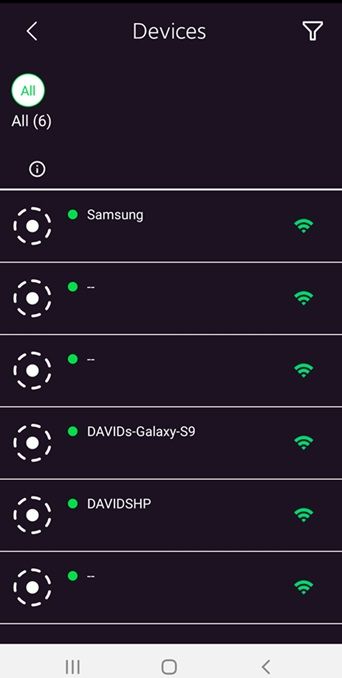

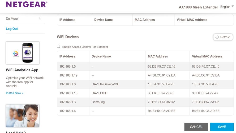

    • dtaft's avatar
      dtaft
      Click the icons....No Icons here on the web login.    If you mean the APP, I have clicked on everything I can see.

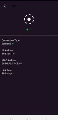

      • dtaft's avatar
        dtaft
        App main page... I click the white dot with circles, the named device, the unnamed .... all they do is pull up the devices info, there is no way to edit the device name here. When I am looking at the device info, there is nothing there I can click which pulls up a way to edit it either. I press the dashes, the white doted circle icon, and the .. next to the green dot.   None of them do anything.

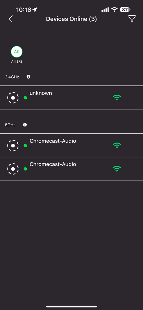

      • donalcombright's avatar
        donalcombright
        Guide
        michaelkenward wrote:
        You don't say if it is iOS or Android.
        iOS
        There is the hidden "Edit" button in the Network Map. Drill down to the device you want to manage and look for the button next to the device icon.
        I have no button anywhere when browsing the extenders in iOS or on the web interface. Do you have a screen shot of a hidden button? Note unknown is my Rachio, which Orbi does a somewhat better job of naming, but at least I can organize it if it doesn't.
