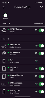

For 2 months before I updated firmware to 1.1.6.6, everything on the App was working fine.
- The device manager showed me for each device:  (i) connection type - whether connected to router, or to satellite 1, 2, or 3; and (ii) band and link rate.
- The network map also worked properly:  when I clicked on the router or any of the satellites, it showed me what devices were connected to it, what band they are on, and the link rate.
Here is what they looked like before I updated the firmware:
Device Mgr - Before Firmware Update

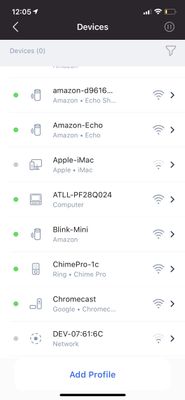

One week ago I updated the system to firmware 1.1.6.6, and everything has gone to hell.
- The device manager list looks completely different -- it is a white interface (not gray like before), tells me nothing about which component the device is connected to, or the link rate

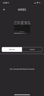

- Worse, the Network Map shows me "no connected devices" for all of the components -- the router and all 3 satellites.

Device Manager - After Firmware Update
Network Map - After Firmware Update
Although I can still see in Device Manager what devices are connected to my network, that is the only information I now get.  I have no idea what devices are connecting to each satellite or the router or what link rate they have (and none of these details are available via the router's firmware page either).  This leaves me no ability to assess or optimize the architecture or connections in my network.

  • Don't know what happened with the photos - let me try again:
    Device Mgr - Before
    Device Mgr - After
    Network Map - After
