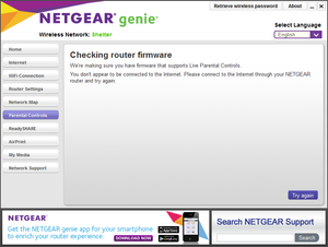

- gworleyOct 17, 2015Aspirant
The current version crashes with "NETGEAR Genie has stopped working" A problem caused the program to stop working correctly. Windows will close the program and notify you if a solution is available.
Version 2.4.14 crashes with the above also 2.4.12. seems to be working at work. Lets see what happens when I get home.
- gworleyOct 20, 2015Aspirant
Culrrent Status:
- Did a factory reset of my laptop: Windows 8.1
- Installed the latest version of the the website
- Everything worked at both work and home
- Upgraded to Windows 10
- Netgear Genie ran once. After a reboot "NETGEAR Genie has stopped working" at both places
- Uninstalled and removed %UserProfile%\appdata\local\NETGEARGenie folder
- Reinstalled and had the same failure
- Uninstalled and Instated 2.4.14 with the same results
- Uninstaled 2.4.12 and installed 2.4.12 worked properly at work but didn't not at home -- could not change setings or should I say could change them but they reverted back to previous settings at home.
- I did a clean install of Windows 10
- Installed the latest Netgear Geniue and had the the same results as with an upgrade from Windows 8.1. Only version of Netgear Genie I could get to run is 2.4.12 and worked properly at work (WNR2000v3) but not at home (WNDR4300) on a clean install of Windows 10. I can go to OpenDNS website and change it to moderate but it never translates to the router. I can change it on the router which has sent me to the website and it still remains the same as when I first setup it up or most of the time it says I don't have a connection to the Internet. Sometimes I can clear this up by rebooting the computer. However, I should not have to restart the computer.
The newest version says compatable with Windows 10 well it seems that even with a clean install of Windows 10 that it isn't.
