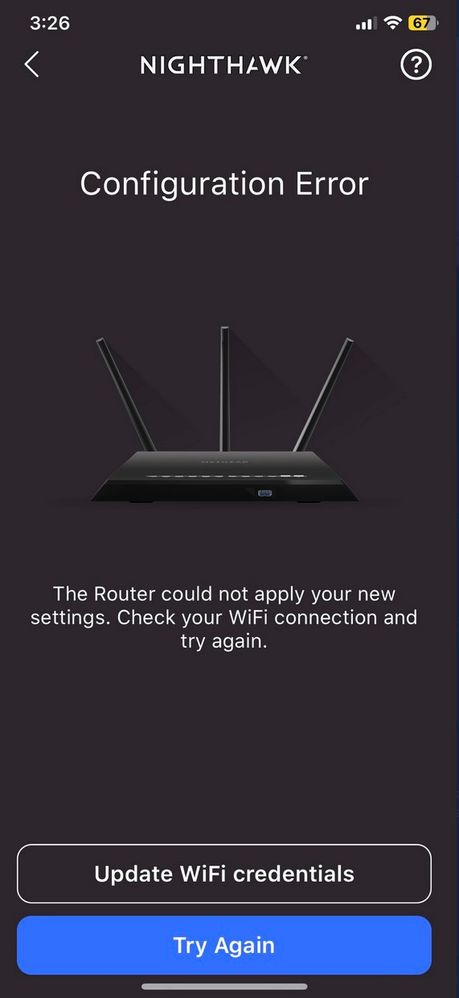

Unable to get through the app set
I got this router to pair with my att router but its not working
I updated the wifi credential, and tried again and again... it doesnt work and my router is not working.

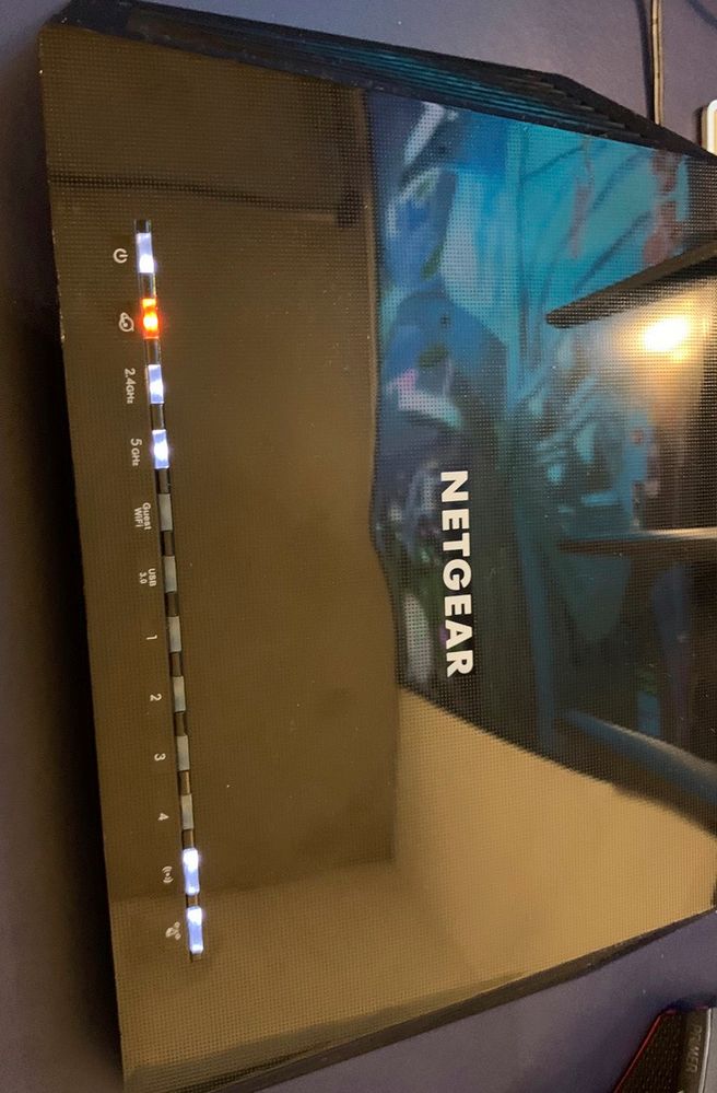

There's a red light in the internet section
