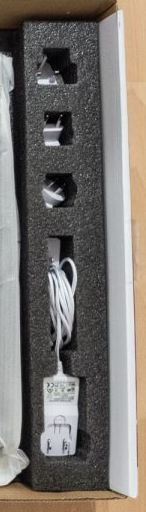

    This is a (bad, sorry) picture if a Meural -10000S power supply and adpaters to fit AC wallplates for many standards in the box:
    Remains the logistical (and financial) challenge to provide you with such a kit. Or you look into a 110/120V->230V transformer.
