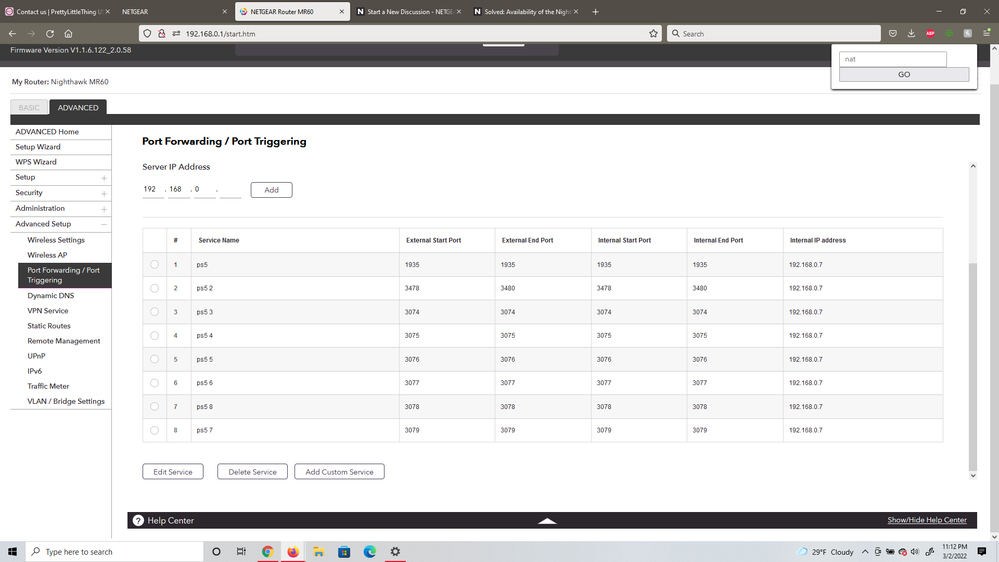

.hello i just upgraded my previous Nighthawk m1 with tp link ac1750 router to my new nighthawk m5 connected to my new nighthawk mk63 mesh system. everything works fine but i can't play call of duty games on my ps5. i believe i had the same issue when i first had my m1 but i forgot what i had to do to fix my issue. i tried changing the dns server on my ps5 to google dns which didnt help. i port  forwarded my ps5 in my nighthawk mk63 settings and that didnt help. i port forwarded cod and that doesnt help. rebooted everything and nothing works. i am able to play other multiplayer games on my ps5 such as yugioh master duel but thats the only other game i tried, but for sure i cant connect to COD servers

    You mgiht set a static IP address on the MRs web page under Advanced tab/Internet. Change from DHCP to Static, input that IP address, Subnet mask would be 255.255.255.0 I believe, Gateway would be the M5 IP address seen on it's LAN side so maybe thats 192.168.1.1 or could 192.168.0.1. DNS you can use the M5s IP address on the LAN or use a custome DNS addresses.
    Or easiest would be to configure the MR for AP Mode then and use the M5 as your host router with its limited router features.
    https://kb.netgear.com/24104/How-do-I-change-my-Nighthawk-router-to-AP-mode-after-I-ve-already-run-setup
