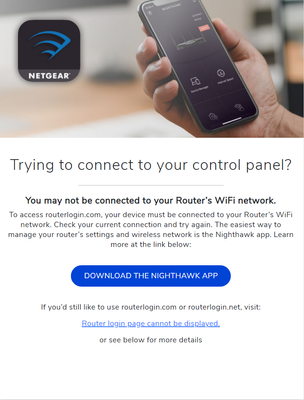

I have tried connecting to my router multiple times through the app but it says it cannot be detected and even through routerlogin.net (and the ip addresses for it), It can't be accessed as it believes I am not connected to my WIFI's router. Also the IP address I can connect to is my AT&T modem. This problem does not allow me to connect to some devices like my console and chromecasts as it can find the network but can't connect. When it does connect, it disconnects the next day leaving it with the same problem. Factory resets have been tried multiple times to avail and the problem still exists.

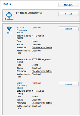

Sorry I should have mentioned that my Modem is already set to modem only and the router and wifi part disabled. The Modem is a BGW210-700
Also for these options that need me to login to routerlogin.net, I can't access that page as it redirects me here.- FURRYe38Guru - Experienced User
With a wired PC connected to the MR, what is the IP address string the PC is seeing from the MR? 192.168.1.something?
And you are sure the modem IS in full modem mode?
