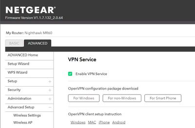

I've enabled (and applied) the VPN sevice on my NightHawk MR60 (FW: V1.1.7.132_2.0.64 which is the current version) and all works fine.
The problem is that when the router is rebooted (eg soft reboot from the gui), the VPN service is reset to off.

    First, I enabled & set up a bogus DDNS.  Rebooted the router and both DDNS & VPN services became disabled (ie issue still occurring).
    So, I did a hard reset (button push) and set up the router again.  Then set VPN service to enabled & applied.  Re-booted the router and ... VPN service remained enabled.
    So, restored the previous backed up settings and rebooted the router.  VPN service remained enabled.
    So, a hard factory reset fixed the issue (thanks for the suggestion).  I'm short of time now so I have not tested if the soft factory reset now works as well - I presume that, too, is fixed.

      Yes, certainly all connections would be dropped on a reboot.  However, I'm referring to the VPN Service on the router, not the client connections.
      Navigate to Advanced tab - Advanced Setup - VPN Service and check the Enable VPN Service checkbox. Apply the change.
      Then, if the router is restarted, the checkbox will be unchecked - ie the VPN Service is not enabled.  In other words, the VPN Service setting is not persistent across a reboot.
      The VPN Service has to be re-enabled before clients can VPN into the router.

        One thing to try, factory reset and setup from scratch. Then do same thing. Let me know the results. IF this continues we'll get this to NG for review.
