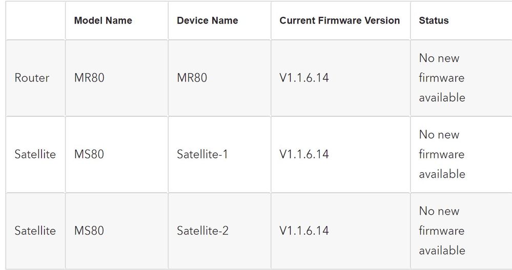

      It looks like my firmware is up-to-date and consistent across the router and satellites. This really seems to be my wireless continuously switching on my devices for some reason.

  • I have the exact same issue. Internet drops for 10 seconds and everything (Alexa, Netflix, etc) scrambles to reconnect. Sometimes I need to reboot router for connection to restart. Firmware installed on router and satellites is V1.1.6.14. I’m thinking of resetting to factory settings. Any ideas would be welcomed.
